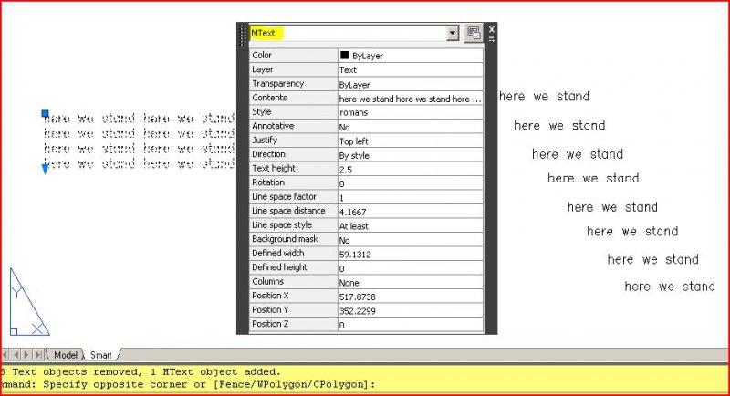

spittle Posted January 22, 2013 Posted January 22, 2013 (edited) Is this possible? The problem with the express tools is that they place these single line text objects into one MLtext which is not what I want. Edited January 22, 2013 by spittle Quote

Dadgad Posted January 22, 2013 Posted January 22, 2013 The description for T2M uses the phrase "individual MTexts". That it does, but in my experience, even using the Options at the commandline, it always creates a new single MTEXT, like in the image. Actually that is exactly what it does, it changes an individual text (or texts depending on your selection group) into a new individual MTEXT object. Quote
