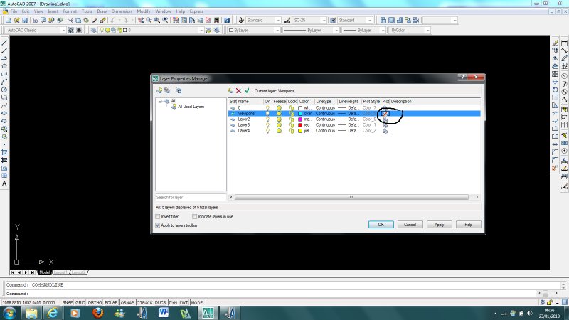

can you help me how to hidden viewports in paper space so
that if i print the drawing no viewport line be seen in printing
thanks advanced

Open your layer properties manager (the little white stack of paper icon) and under 'plot' which is on the right hand side click the printer icon for the layer that your viewport is on. This will stop that particular layer from printing.
You should always, in my opinion, have a seperate layer for viewports.
yeah i got it ...
thanks a lot IAINLINES :D
