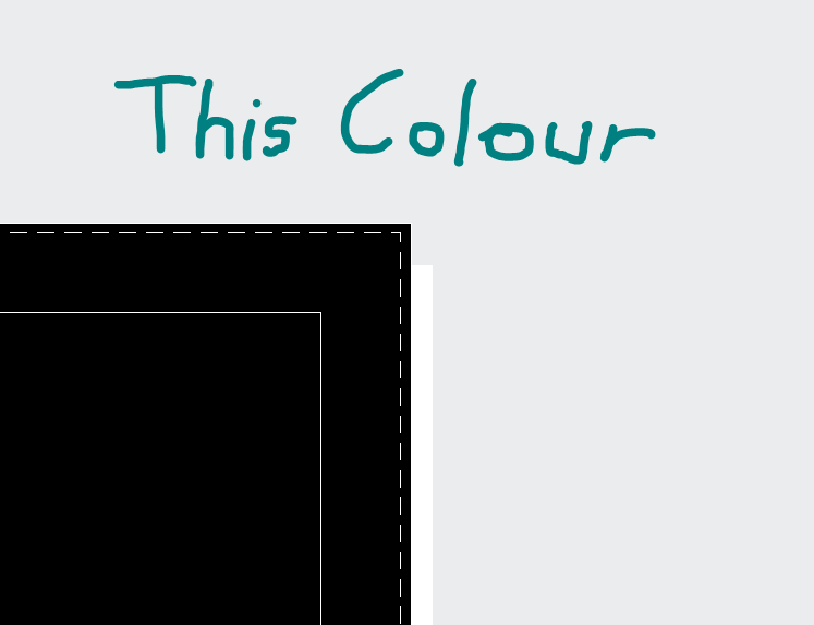

change colour of sheet background
i could not find the item.
the colour is 234,236,238
oh sorry and using version 2012 (didnt update my profile)
What do you mean you couldn't find it? Which item are you looking for specifically?
Do you want to change the color of the background in model space or in a sheet/layout?
When I use 234,236,238 I get a message that says it is not a valid color name or value.

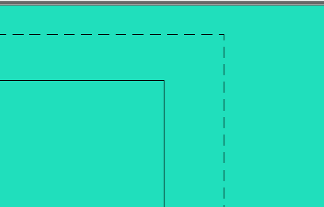

I've searched that too in Acad 2013 (change Color in Layout behind paperspace :) )
And my answer is : Not possible to change that color !
Maybe using some vb.net acad-pimp like changing the backround picture in ribbons
Or you deselect Options>Display -> Layout-Elemts -> Show paperspace
then it will show you the color you can edit following 2nd post
dont really lile going uniform... :) i like to see the edges
in earlier versions it was a slightly darker shade of gray but now its too light and i dont see white lines clearly over it
