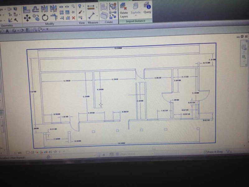

kililio Posted January 24, 2013 Posted January 24, 2013 Hi, Ive made a floor layout plan on Autocad 2012 save it as .dwg now i'm opening Revit architecture 2013 and want to import this project into it how can I do that? Thanks! Quote

kililio Posted February 4, 2013 Author Posted February 4, 2013 Hi How can I use this .dwg file in Revit after linking? I want to modify things like walls etc. I saved the project into .rvt file now once I click I got blue box and impossible to modify any walls How to do that? Thanks Quote
RobDraw Posted February 4, 2013 Posted February 4, 2013 Hi How can I use this .dwg file in Revit after linking? I want to modify things like walls etc. I saved the project into .rvt file now once I click I got blue box and impossible to modify any walls How to do that? Thanks[ATTACH]40078[/ATTACH] When linked it becomes a direct reference to the .dwg. If you make changes to the .dwg they will be seen in your Revit model. Similar to XREFs in AutoCAD. If you want a model of the floor plan, you are going to have to build it in Revit. You cannot just convert the .dwg to a Revit model. To modify the walls, you have to be in AutoCAD. If you linked the .dwg, the changes will show in your model. Quote
kililio Posted February 4, 2013 Author Posted February 4, 2013 Thx Rod I should have done all that in Revit first now I have double the work Quote
