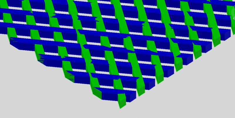

Sukayna Baydoun Posted January 24, 2013 Posted January 24, 2013 i've draw a poly line but i am not able to extrude it, its not working Drawing1.dwg Quote
CarlB Posted January 24, 2013 Posted January 24, 2013 The error message helps explain: Cannot sweep or extrude a self-intersecting curve. 1 object removed from selection set. Your polylines are not "clean", they have an overlapping segment and are not closed. Quote
ReMark Posted January 24, 2013 Posted January 24, 2013 You can give the closed polyline heights using the PressPull command but doing so the way you have the pattern constructed might be time consuming. Can I make a suggestion? When you have gone through all the trouble of creating a layer and assigning a color to the layer would you please consider NOT overriding the layer color. Color should be set to ByLayer and adhered to as much as possible. Quote
ReMark Posted January 24, 2013 Posted January 24, 2013 Height = 5 units. Now what did you plan on doing with it? Quote
Sukayna Baydoun Posted January 24, 2013 Author Posted January 24, 2013 thanks a lot, CarlB, its right, i've just cleaned them and it worked:) Remark, its really important to manage the everything by layer, thanks Quote

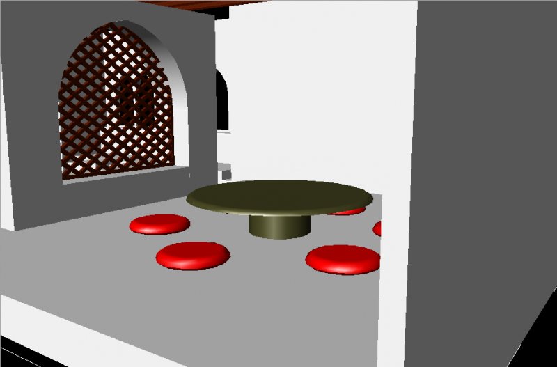

Sukayna Baydoun Posted January 25, 2013 Author Posted January 25, 2013 its a decorative grid (mashrabeye) Quote
ReMark Posted January 25, 2013 Posted January 25, 2013 OK. We call that "lattice". I am familiar with it. Thanks. Quote
