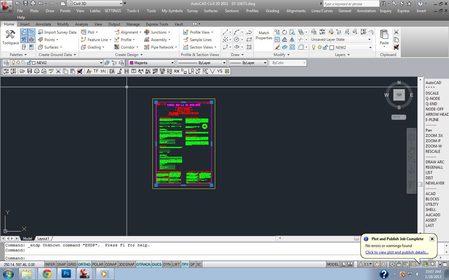

Gentrysurveying Posted January 29, 2013 Posted January 29, 2013 our office recesently upgraded to cad civil3d 2011 and we are having a hell of a time trying to get the ploter to plot right. we have got it set up with out line weights and all the stuff need to plot out drawings. it have set up custom paper sizes we are using 18"wx26"h when we plot we pick a window like we did in land desktop and select center. when it it plots it is off center my 7/16" of a inch to the left and nearly 1.5" too long. we have tried to adjust the offset points to center the plot. and have made it centered left to right but still come out at 27.5 " when i change the paper size to say 18x25 it just cuts off the top of the drawing? any help would be great! BTW im a Cad newbee i just started working here 4 months ago... first time using cad. Quote

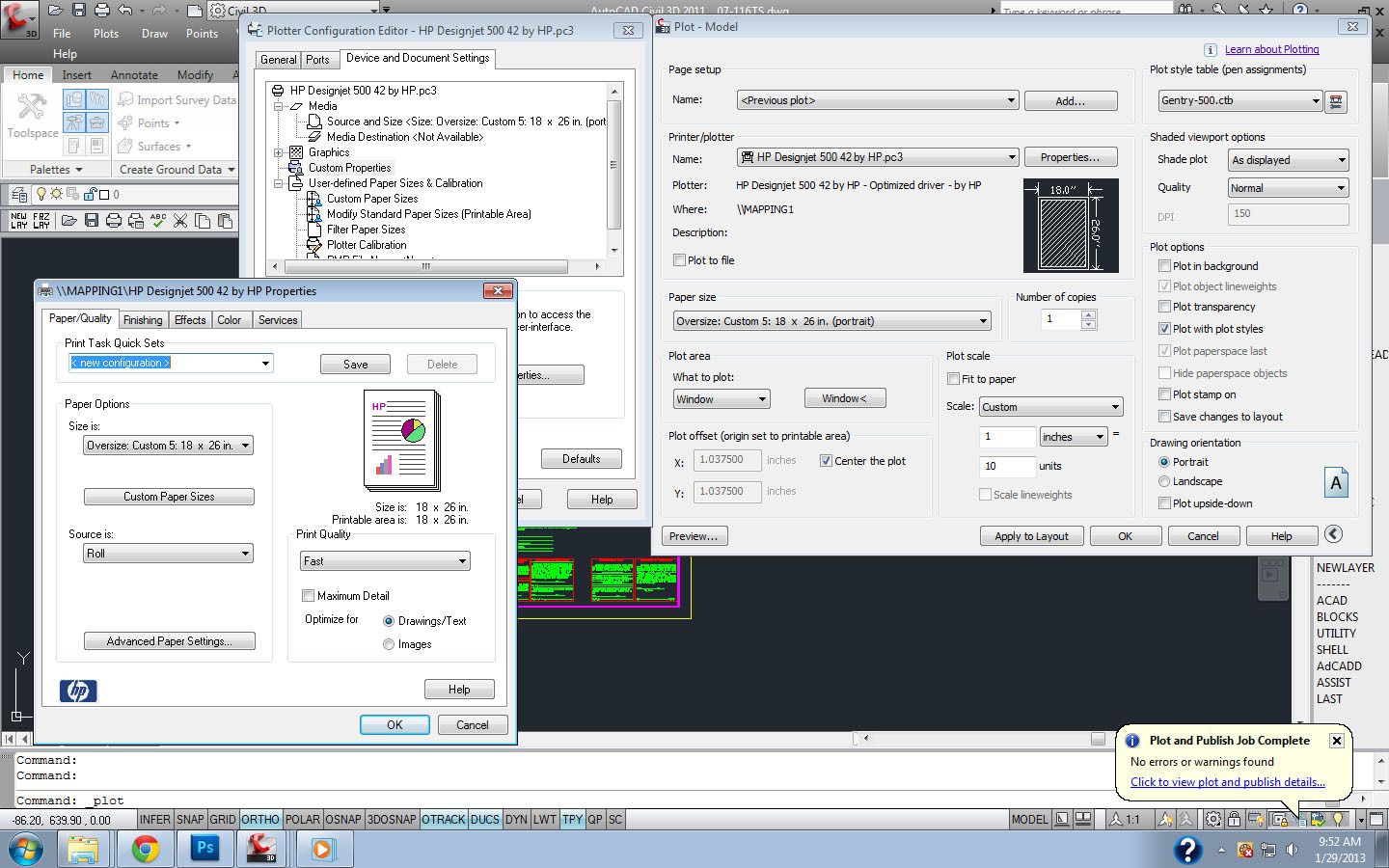

ReMark Posted January 29, 2013 Posted January 29, 2013 That (18" wide roll) was not a wise decision. What are all your plot parameters? You can post an image of your plot dialog box to save typing them all out. Quote
Gentrysurveying Posted January 29, 2013 Author Posted January 29, 2013 we have used the 18" roll for years here and it works if we plot on out old version of Land desktop but not in civil3d here is my settings. Quote

Gentrysurveying Posted January 29, 2013 Author Posted January 29, 2013 yes it is capable of printing a 42" wide im plotting directly from model space. here is the space im selecting to plot the yellow box is the paper size the purple line is a border that need to be offset 1" on all sides of my print as per city requirements its printing out at 18' wide and 27.5" tall with a 1.675" offset top and bottom and 1.00 on the side when i enter .732 on the x and 1.0 on the y im picking the end point on the bottom left of the purple box and the top left of the purple box. Quote
ReMark Posted January 29, 2013 Posted January 29, 2013 It does not appear that scale is important. Try checking off the box for "Fit to paper". Too bad you elected to ignore my other questions. Quote
