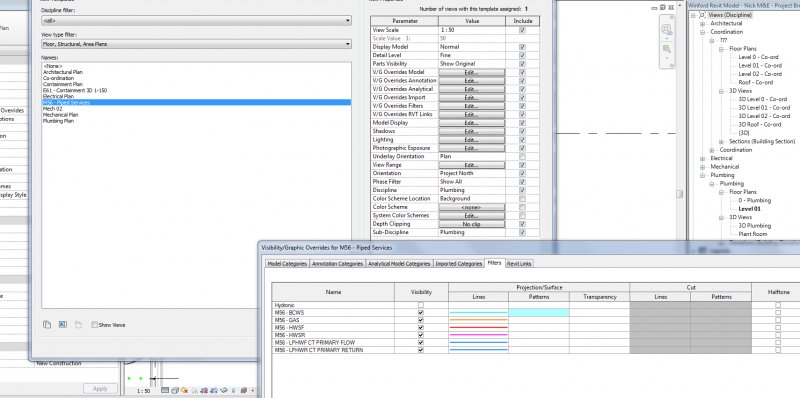

Ive set up some new piping system types. and also set some view filters (colours) for the types in my view template..
The new pipe systems wont show for some reason, :unsure:
really dont know what im doing wrong, the new systems seem to have the same properties applied that show in the view
anyone got any ideas on what im doing wrong?

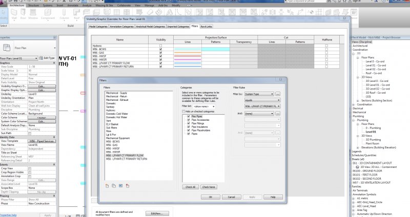

What ive been doing is:
Duplicating say the Hydronic supply, naming it something else (LTHW-F)
Then adding filters for the system type for (LTHW-F) in my view template.
but the ones ive duplicated wont show?
When you Reveal All, do you see the pipes? Also, is your Filter set up properly? Can you post screenshots of your Filter setup?
Is your filter turn on (checked)?

I have attached some screen shots..

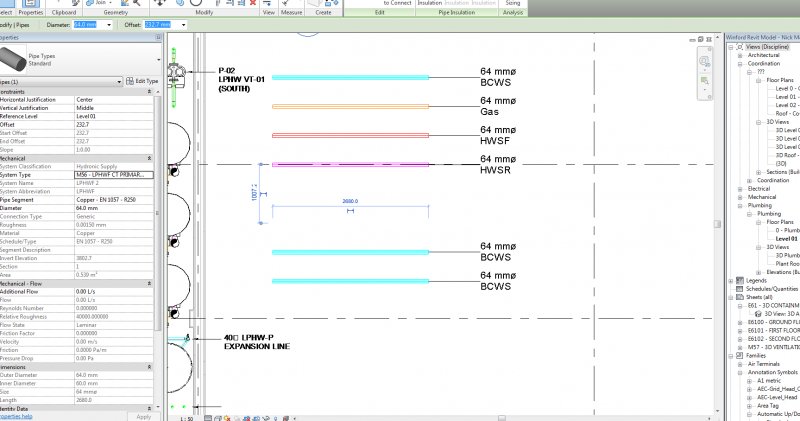

as soon as I change the say the HWSF pipe to the LTHWF CT PRIMARY or any other apart from the 4 shown, they disapear :?
They dont come back when I reveal all either :unsure:
Hope you can help, im sure its probably something and nothing
