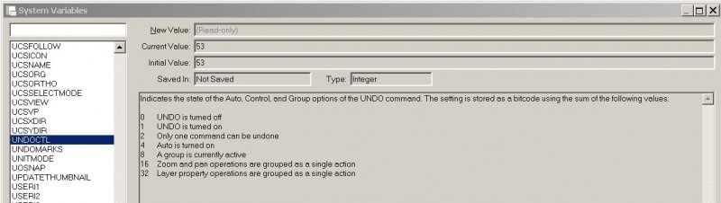

Guys Here i am Posting a Routine to erase Object with undo option i got problem here
after erasing any object if i press undo .. everything is going back

I do not write lisp, but it seems likely that you may need to set the UNDOCTL system variable to enforce the behavior you are after.
If you do so, don't forget to return it to the previous value before completing the lisp.
Dadgad is right, the said variable may have influence on the behavior of your routine, but unfortunately you cannot affect it directly since is Read-Only.
Instead, try to create an undo group for each erase operation.
