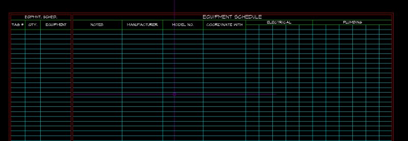

I am trying to use data extraction and create a custom schedule to look like this:
But I cant get anything but the standard autocad schedule.
Any suggestions would be greatly appreciated
Thanks
At the end of the Data Extraction wizard, just select the Table Style that you need and it will inherit the "look" that you're after. :)

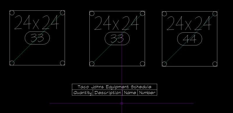

I select the table style that I created but i still get the standard table? Oh by the way Im on Autocad Architecture 2008.

When I use schedule I select the three blocks shown and all I get in the schedule are the headers ie: no quantity count or equipment number(the number in the oval)

Select the Table, right-click, select "Edit Schedule Table Style". Under the Columns tab, select the column you need and check the "Include Quantity Column". OK when done.
Now select the Table again and select "Add All Property Sets". This will give you what you need. :)
