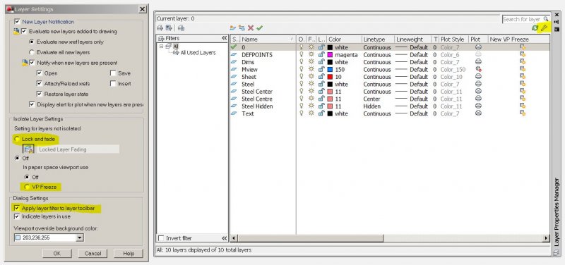

I didn't test this hypothesis, but you might want to look at the images and see if they suggest a solution.
The dialog was called up by the little wrench icon in the upper right hand corner of the Layer Properties Manager.
Might you have any layers isolated?

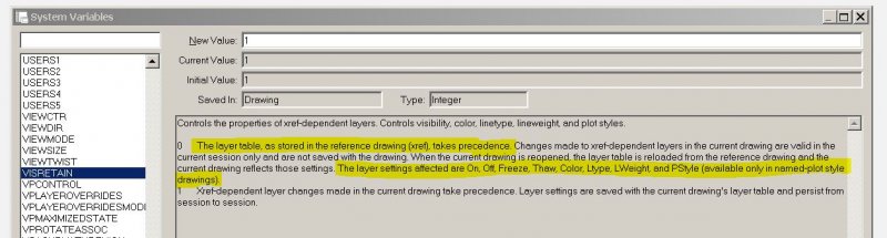

You might also take a look at the VISRETAIN settings described in the other image.
