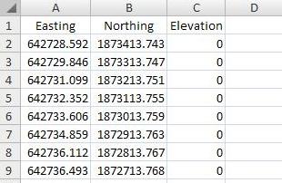

one more thing i want to ask you is,,, I want to put header on each column Just see attached image
(defun c:1 (/ file dta p i)		;POints to TeXT
