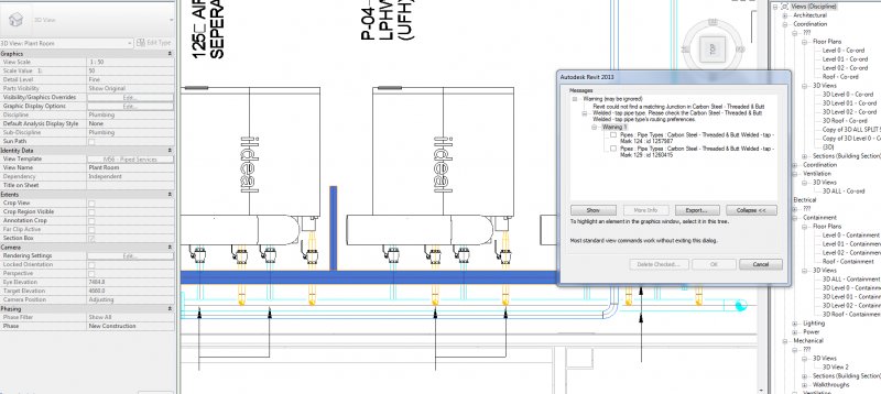

How do you make a tap instead of tee off a pipe run?
Ive changing the routing preferences and changed it from tee to tap, and it wont do it for some reason.
For Revit MEP 2013: Click once on a pipe that already exist in the model. Click the Edit Type button, then under Segments and Fittings > Routing Preferences click Edit. This is where you can access this information quickly.
Alternatively, you can expand Families > Pipes > Pipe Types, then right-click any Pipe Type and click Type Properties.
I think i did that, and it came up with an error when i tried to change it

I take it there is no tap family loaded only tee. but ive managed to select tap in the routing preferences
