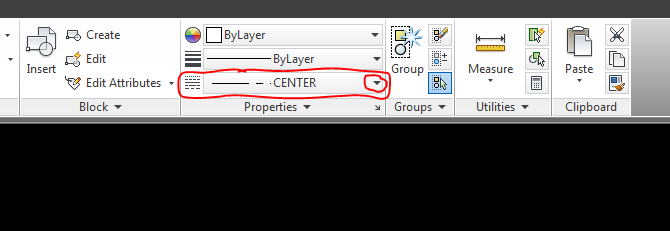

Your linetype for any given layer should be set to "ByLayer".
Look at the top of your screen (Home tab > Properties panel).
See if the linetype says "Center" in the location enclosed in red. If it does this needs to be set to 'ByLayer'. Do that by clicking on the Down pointing arrow, circled in red, and then make your selection. Test it. What happens now?
