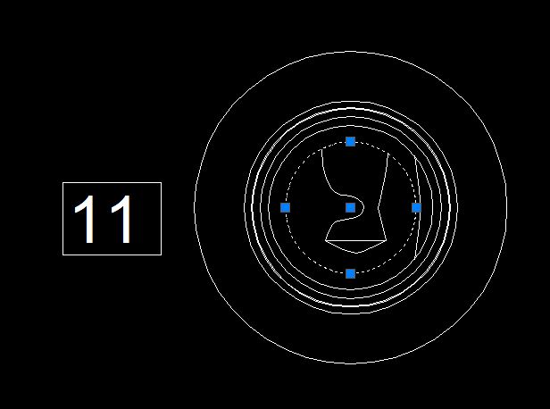

Hello guys. I am looking for a routine that would allow me to select a circle and basically remove all geometry within it. We use Inventor to design our manifolds, we then also export out the faces for the programmers to use. They have issues with the extra geometry that is exported. So I now have to manually select all the unwanted geometry and delete it prior to releasing it to them. Has anyone ever created or needed such a routine? I have attached both a picture and a cad file for reference. Hopefully this is clear, but if not please let me know.

Try this draft at the moment . :)
  (defun c:test (/ s i sn ss lst le di j)
 (vl-load-com)
 (if (setq s (ssget "_:L" '((0 . "CIRCLE,LINE"))))
   (repeat (setq i (sslength s))
     (setq sn (ssname s (setq i (1- i))))

I really appreciate your quick response to this. This seems to work quite well, I noticed that this removes everything that is not a true circle. This is exactly what I wanted but I now noticed that there some geometry produced by Inventor that is not true, thought i may look like it. A few of the circles when listed show as a ton of line segments that make it up, not an issue, I'll just need to be aware as I'm going.
Thank you again for your help with this, I took a LISP course back in '97 and have not used it since, so I wouldn't have gotten very far very quickly without your help. This works great for now as-is.
On a semi side note, do you see all the text with bounding boxes on the .dwg? The bounding boxes must also be manually removed and unfortunately they do not come in as polylines so it can be quite tedious to remove them all. Would you have any ideas for a solution to this? If I could just RMB drag to the right and select the whole text string and bounding box then have a routine to remove just the bounding box, that would be awesome.

Actually they are lines and it is easy to write a simple lisp or include more codes within the first lisp to delete the selected lines .

CODES UPDATED IN THE FIRST POST

Wow, that works great, thanks again for all your help.
