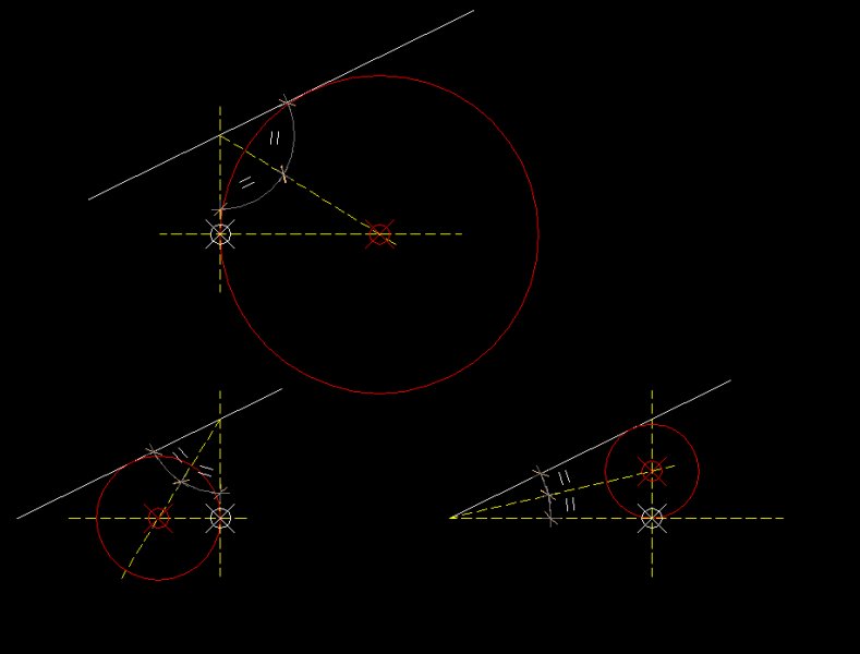

Can you please post a sketch of that case? I'm not able to understand it from your description - a line can be tangent on quadrant only to a horizontal or a vertical line, not a sloped one.
Reading twice your requirements, is this the case you were looking for?
If the above sketch is correct, then the formula of radius for the desired circle is:
Radius = Distance / (1 + Cosine(Angle))
where:
  • Distance means the distance from the given point to the given line.
  • Angle is the angle made by the given line with X axis.
If I will have time later, will try to write you a routine for this.

Thanks for your replies. I'm sorry, I could not make you understand actually what I wanted. I'm enclosing an AutoCad drawing showing the sketch. The drawing is self explanatory.

ah, that's clearer.
One way (may not be the best)
draw a vertical line through your fixed point.
mirror your angled line
CIRCLE 3P
tangent to one sloping line
select fixed point
tangent to other sloping line
Done.
So, it looks like Stefan's top version. Nice solution, Dave. It doesn't get much simpler than that!
