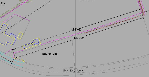

keatzz Posted February 20, 2013 Author Posted February 20, 2013 I dont want to mess up my coordinates. let me attach a cut out of what i am working on now. example.dwg Quote

keatzz Posted February 20, 2013 Author Posted February 20, 2013 I may be wrong, but I read the request as being able to DRAW in the Imperial Drawing (dimension input) using metric input without converting the drawing to metric.. Basically if you check my drawing, the line which has the dimensions on it shows 20m and in drawing units its 66.7 (i.e. feet). Instead of drawing a line with input 66.7, is there a way i key in 20 and in the drawing it draws out a line with 66.7 units Quote

ReMark Posted February 20, 2013 Posted February 20, 2013 Did you know that your rectangles do NOT have ninety degree corners and that opposite sides are NOT the same length? I also believe that your inherited drawing has been done using decimal inches. Using the Distance command and measuring across the length of the smaller rectangle, midpoint to midpoint, AutoCAD returns a distance of 66.8565 which if converted to feet and inches would be 5'-6 27/32". It seems you are nowhere close to being 66.7 feet which in feet and inches would be approximately 66'-8 3/8". Quote

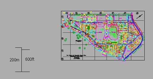

eldon Posted February 20, 2013 Posted February 20, 2013 I am not sure as to why you are so averse to scaling the drawing. If you always scale about the point 0,0, then coordinates will be preserved. I have the need to draw in both Imperial units (canvas marquees only come in feet) and Metric units (Frame tents only come in metric), and I have set up a scaling aid as shown. Merely Scale by Reference. Very easy as long as you remember to have all layers unlocked and on Quote
