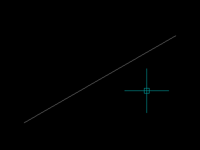

Hi all,
used to have a fair amount of lisproutine back in the days, but it's all lost when I changed jobs (a decade ago...) and to LT.
Now I'm trying to write (recreate) a lisp, but my memory is not what it used to be... and this is probably very simple, I've tried to look for it on the forum, but could not find it...
What I want: there is a line, you pick begin and end point, you click to one or the other side of the line and on that selected side of the line it draws something...
See attachement: A line (pt1 and pt2) and a point which can be on either side of the line (i.e. left or right if it's a vertical line) I've drawn a circel to indicate the two possible quadrants, in this case left and right. Most lines will be vertical, however on some occasions the line can be at a different angle.
Once these three points are selected, the lisp will draw a set of lines perpendicular and parallel lines to the primary line, at set distances (drawn in red).
My problem is that I can't get my head around about how to select which side of the line. I'm pretty sure it's something simple, but I can't remember how it's done.
This is what I've got sofar. I can select the three points, I can draw the lines, but someting goes wrong with calculating the angles and it draws the lines basically not where I want them to be...

So my question is, does anybody have a solution to my problem? It's driving me... I know I'm close, but yet so far...
thanks for having a look!

a different approach

hope that helps
Henrique
This looked like an interesting program so I experimented with a 'dynamic' version:

The above should also perform successfully in all UCS & Views.
A different different approach you do not need the second pick desired side
In the prompt message you say "pick left hand End" this then implies which is up and down, in v's out then like code above you compare the distance to the end & start pts to work out the correct "Left" end, with a little practice you get used to picking lines that are upside down for direction.
Hi all, thanks for your replies! This helps me out a lot. Been away a few days, saw the code yesterday, but out of reach of my acad machine... Couldn't wait till I got back and test the codes!
@hmsilva thanks, nice and short, does exactly what I wanted it to do! Although it also means I need to read up on my Vlisp... This will certainly help me out.
@LeeMac also thanks for your effort, this looks very slick, although I still need to dig in to find out what does what in this code! But it's very nicely done with being able to select a side in wysiwyg-mode!
Now I need to try and incorporate it in my lisps. Thanks all
