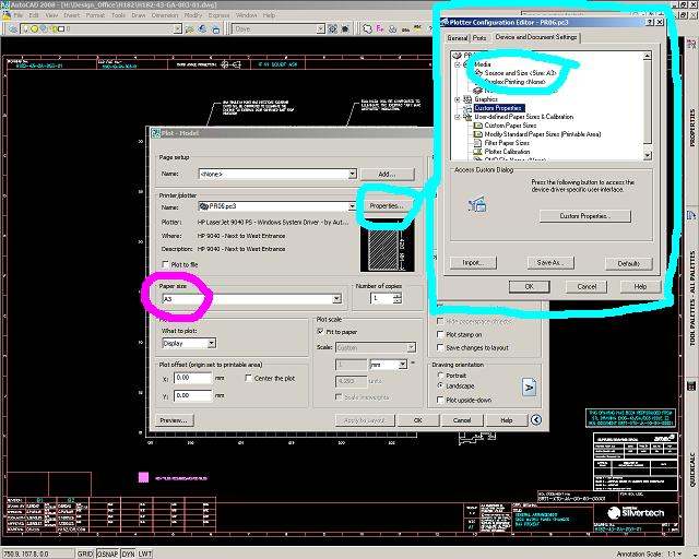

I'm not sure what your problem is but here are a couple of places to check. CTRL-P to get the print dialogue up. The paper size should set from the magenta drop down. Press the cyan button and check what is set in the .PC3 file. There is a similar screen within the windows plotter configuration I think. Is A3 available there?
Dbroada illustrated my point. Although there is a custome properties button underneath. It's the advanced settings in that custom properties feature that will also need to be set to your desired size.
