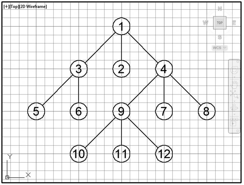

Sample program using TRIM in a 2D context...
Load it and try in a darwing with a series of lines typing GRAPH in the command line:

;;;Listing 12.2. Function that draws circles at the line endpoints.

;;;Listing 12.4. Graph nodes numbering function.

;;;Listing 12.5. New command that automates the creation of network diagrams.

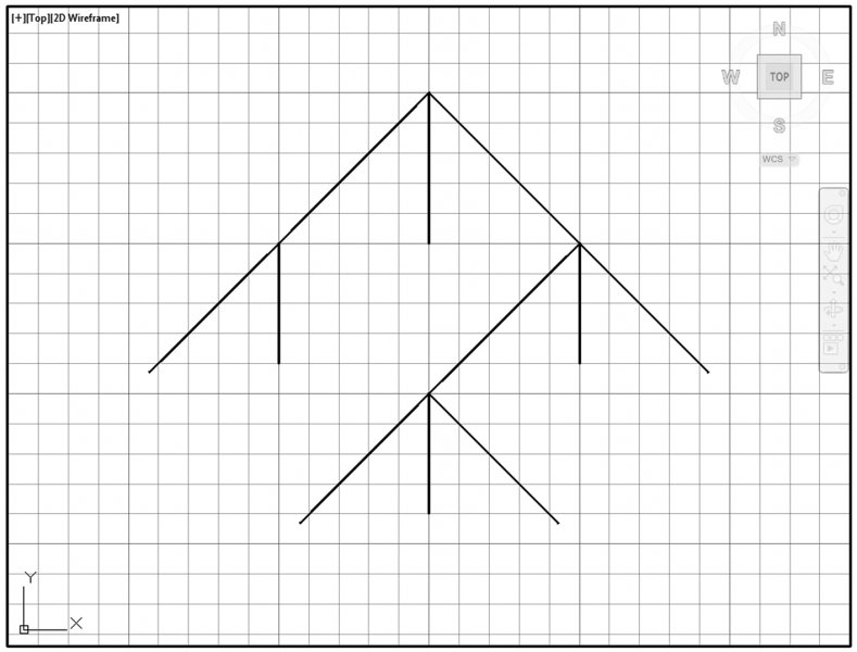

Command FILLET is essentially interactive. A solid with rounded edges can be programmed as a combination of solid primitives, i.e. a complex solid.
There is no FILLET method as you already know. So the way would be programming a complex solid.
As an interactive TRIM for solids, you can program it as the reference I included shows. Of course it is nothing but a way to use the existing methods, nothing else.
But it can save a few mouse clicks. After all that's what AutolISP is all about.
By the way, the object I use as avatar is a 3DSolid made using AutoLISP... somewhat complex, I believe.
