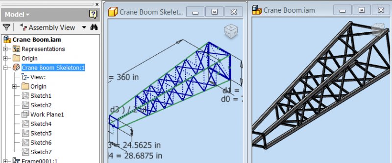

JD Mather Posted March 6, 2013 Posted March 6, 2013 The box is a surface body created by Extruding a rectangle (in this case a square) as a Suface Body Output (see the Output options in the Extrude command). This give planar faces on which to create sketches and also gives reference for the size/shape of the boom. It does not appear on drawing (unless you set it to) and in fact can be turned off at any time (find the Surface Bodies folder at the top of the browser, you can right click on it and unselect Visibility). Surfaces are infinitely thin and have no volume, weight or other material properties. A common example is to use as "keep out zone", in other words a machine might take up this envelope of space - so build the frame around it keeping out of this surface boundary. Quote
JD Mather Posted March 6, 2013 Posted March 6, 2013 Here is an example I did 6 yrs ago (before I knew what I was doing). Note that this was done in educational license - so delete after examination. Edit d5 and change to zero and update. Crane Boom Skeleton.ipt Quote
trussman Posted March 6, 2013 Author Posted March 6, 2013 OK that makes sense sort of , as you mentioned the box being a surface body and it being a rectangle or square in this case what about a triangle truss how would I go about doing that? Quote
JD Mather Posted March 6, 2013 Posted March 6, 2013 OK that makes sense sort of , what about a triangle truss how would I go about doing that? Create a Polygon 3-sides and extrude. (Note that a polygon does not automatically have a horizontal or vertical constraint on one of the lines - you must add it.) If the ends are different sizes then Extrude with Taper (if you know the angle) or Loft if you know the beginning and end sizes but don't want to calculate the angle (especially as as in my Crane Boom example where the angle will change or not be uniform on all sides). I like to use geometry to do my calculations for me rather than trig. Quote
