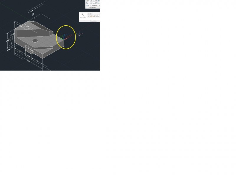

I have a problem in my ucs icon when i am drawing/rotating and dimensioning my drawing.. the ucs turns to have extra lines and even the dimensions has unnecessary lines. how am i suppose to fix this
Edited by KharizzaJeh
Looks like a graphics card/driver problem.
If you open the same file on another computer (with different specifiations if you are working in a school lab) does the problem still appear?
Thank you very much Sir!
I tried opening it on another computer and the extra lines didnt appear... Thank you!
