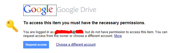

GP_ Posted March 5, 2013 Posted March 5, 2013 ...I posted a link to the drawings if you didn't see. I sent to you a request for access, but I have not received a reply. Quote
