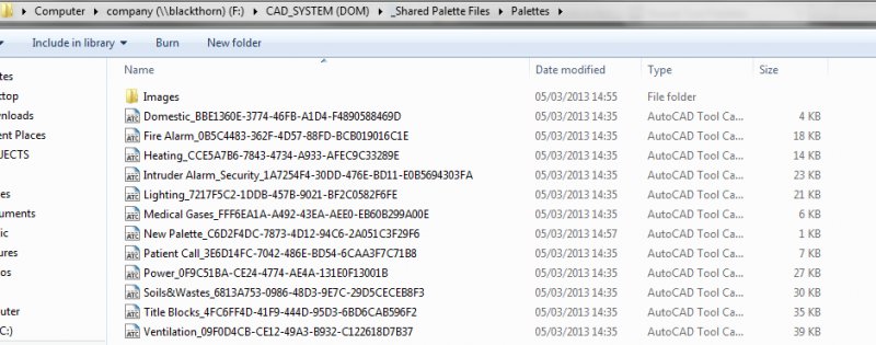

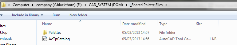

dsibbo Posted March 6, 2013 Author Posted March 6, 2013 OK I am still a little confused. I have copied all the files onto the shared network as in the 2 images. I can go on a colleagues computer and then what is my next step? Quote
Mike_Taylor Posted March 6, 2013 Posted March 6, 2013 You will want to add the folder on the network to the Tool Palettes Support Files under the options. Quote
