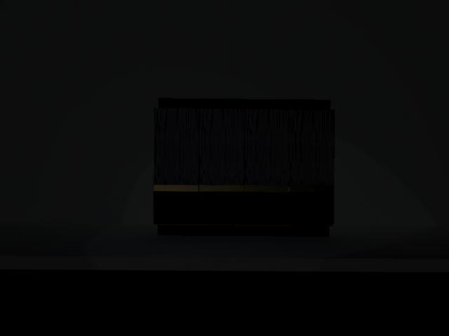

Can some one please help me. I had the new 2013 3ds max installed on a home pc and am trying to light a custom of furniture. Too dark. I seem to have forgotten how to adjust the standard spotlights.
Currently have two target spotlights with an energy of a billion... I am missing a step obviously. I am using a camera and have it set to mental ray render. It might be that I need to adjust the scene space. I am a newbie so am not allowed to add a link. Is there any way to upload a jpg?

Post a render and a screen shot of your light settings and I'll take a look.

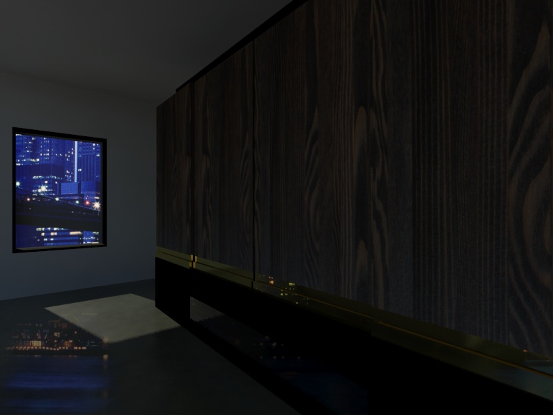

I realized late at night that I had had been using the mental ray renderer with the photometric preset while only using standard lights and that was the problem in terms of not enough light. When I asked my tutor the next day he told me to build a scene and add daylight... which is can be seen in the second picture. It happens to be a close up of a custom cupboard.
The thing is if I can't use daylight how do I effectively create natural looking light indoors?
Unless you're doing a product shot, where you would set up a 3 point lighting system to mimic studio lighting, you will always use daylight. If you're doing architectural interior renderings you will most likely have windows somewhere within the room you're working on. Even if those windows are not shown in your render.

render menu
exposure control
mental ray exposure control
set Exposure value to 2
Profit!??
thank you Raudel, I am doing that now and everything looks good. does profit mean?! ... mean that does that help? then the answer is yes.
