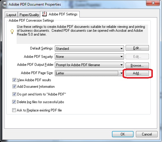

Did you look at the ADD button?
[ATTACH=CONFIG]40673[/ATTACH]
where is this screen shot from? is this in autocad or adobe?
Adobe PDF. ..................
