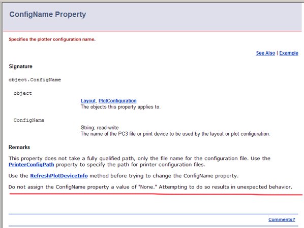

I'm not sure if this plays a part in anything, but it might be something to consider. From the Developer Docs:
Thanks for that note SEANT, but I had already checked that out.
I solved(/got around) my problem by just applying the printer to "none" and the page size to Arch D in order to get the 'white space' in the layout to resize. The respective lines of code would be:
