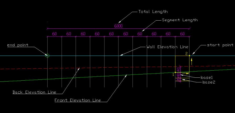

Im very exited to pronounce my first project in Autolisp. I know it much more than I can chew, but the reasonfor my excitement is that this program can save my hours or even days in my daily work.
I tried to make it ease to follow as much as I could. I write to commands in plain English, I draw and annotate all the steps and even publish a flowchart.

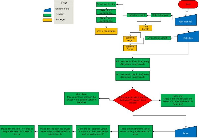

Program overview:
After dividing a total length of the wall to x number of segment (restricted to outcome to min length and max length of each segment (thanks marko)).
The program simply needs to examine the distance between the front and back elevation, and draw a wall (upground) and a base wall (underground)
Than drawing a rectangle from the lowest point to the wall (forming the wall) and then drawing the base wall depending on the distance between the front and the back elevation.
;** GET USER INFO **;
;get the start point
;get the end point
;get the wall elevation line
;get the front elevation line
;get the back elevation line
;** PROCESS DATA  **;
;divide the (total length) so the resulting (segment length) wont be more than (max length) and not less than (min length)
;** DRAW **;
;Add vertices to (wall Line) every (Segment Length) units
;Add vertices to (Front Line) every (Segment Length) units
;Add vertices to (back Line) every (Segment Length) units
;loop as segments counts , offset every segment length
   ;get (front elevation line)  verts in (start point) x axes
   ;get (back elevation line) verts in (start point + segment leng) x axes
   ;Which vertex in which line has the lowest Y value in the 4 vertices
       ;if (front line) than Place a dim line between the lowest Y to a parallel vertex in (back line)
       ;if(back line) than Place a dim line between the lowest Y to a parallel vertex in (front line)
;**draw block**;
;draw a line from the lowest vertex to its other vertex
;draw a line in the y axes from the last vertex to the wall elevation vertex
;complete the rectangle
;**draw bases;
;if the dim is more than 0 and less than 50
   ;than offset the lower line 40 units
   ;and offset the lower line 60 units
any thought are welcome!

To put it simple, so far I got the total length from user and then have it divided (original code writen by marko_ribar), so now I know how many segments I have and each segment length .
Next step is to ask the user which line represents the wall and which lines representing the front, back and exist elevations (not sure how to store them)
than i want to destribute vertices along each line wtih "segment length" interval and find the lowest y coordinatein in each segment (original code written by pBe)
i got confused in 2 things:
  1. how i should bound the polylines names(back,front,etc) with their corresponding list of coordinates?
  2. how to get the lowest y coordinate every 4 points along the total length?
