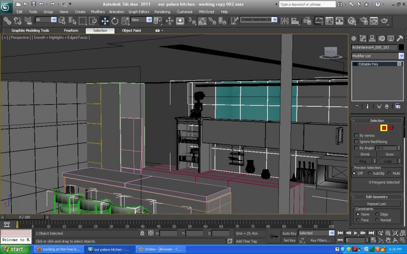

Working on this free kitchen model that I d/l from this site http://www.3dmodelfree.com/
now I'm in the process of adding textures to the various structures of this kitchen, but somehow the black color that's covering everything in the kitchen is hiding the texture bitmaps on the smaller structures (such as the knives/the wire wall rack, etc) so how do I get rid of this black color so that all my bitmap textures would show up in all their glory for when I add my characters and animate them for a mini movie clip?

First you need to determine what the black objects are. Then you can address them accordingly.
I think the black objects are the various parts of this kitchen model. As far as I can recall from the last time I worked on this model, these various objects are not specifically named (like "back wall", "cabinet", "kitchen bar" etc) but are instead numbered (as in "000" or "00", "001" or "01", "002" or "02" etc), and when I click on a numbered part from "Edit > Select by Name" the program responds by putting a white border/selection box/outline around that object. So how do I address them accordingly?
Also, I'd like to do away with the original names (this is some generic name of some kind, starts with an "A")/numbers of these parts and rename them giving them my own names (like "cabinet_front", "cabinet_top", "cabinet_bottom" "back_wall", etc) so I can address each one accordingly - how do I do this?
If they are not named appropriately then you will have to decide what each object is and give them all proper names. This is why I don't like using free models, built by someone else. They are usually made without care for whoever downloads them.

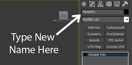

If you want to rename an object, just click on it to select it, and then type a new name into the text box in the modify panel, as shown below.
Today I followed your instructions on how to rename, and as of now I'm starting to select each of these black colored objects in the model and I'm in the process of renaming them, giving them meaningful names, like here:

Can you post one of these "black" models with unselectable polygons here for me to look at?
Or tell me exactly which kitchen model you downloaded from that site, so I can download it myself.

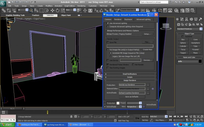

Ok, the reason everything is black is because this file was set up for use with Vray. So all objects have Vray materials applied.
1. Click the "Render Setup" button, or go to the "Rendering" menu and select "Render Setup"
Make sure you're in the "Common" tab and then scroll down to the bottom to the "Assign Renderer" section
Click the button next to "Production: Missing Renderer" and select "Mental Ray Renderer".
2. Open your material editor. You will get a pop window with a list of errors. Don't worry about that. Just close the window.
In the material editor, go to the "Utilities" menu and select "Reset Material Editor Slots"
3. Drag a selection marquee around all the objects in the scene, so that everything is selected, and then apply a default material to them.
Everything should now be the default grey color. Now you can start applying your textures/materials.

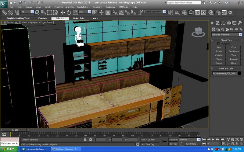

Ok, I added the default gray texture to everything, but why are the small objects (such as the wall rack structures, salt & pepper shaker structures, etc) still black?
Also, I'm trying to get rid of that "block tile" outline on the walls so I can make it resemble our kitchen (our kitchen walls do not have any sort of tiles on them, they're either painted plaster or wall paper) - how do I do this?
Also, in attempting to get rid of the tile outline on the back wall I deleted some of the default gray texture by accident, exposing my old turquoise paint texture that I added before I did this Vray render stuff as per your instructions in the post above this post, and it so happens that this turquoise texture is still sort of dark-looking.
How do I make all these new textures I intend to add brighter like it appears in real life?
And how do I get rid (or at least hide) the white/red, etc lines that are covering the sub structures of this model so that when I add the characters and animate them, it'll look like a movie clip from a home movie filmed with a good video camera?
Nothing in my scene is black. Everything is grey. You must not have selected everything when you applied the default material.
I think the answer to this is pretty obvious. You will have to delete those tiled walls and make new, flat, walls.
Don't worry about that right now. You can adjust your materials later, once you have the entire scene built and lighting set up. And don't concern yourself with how materials look in the viewport. What is important is how they appear in the render, or animation.

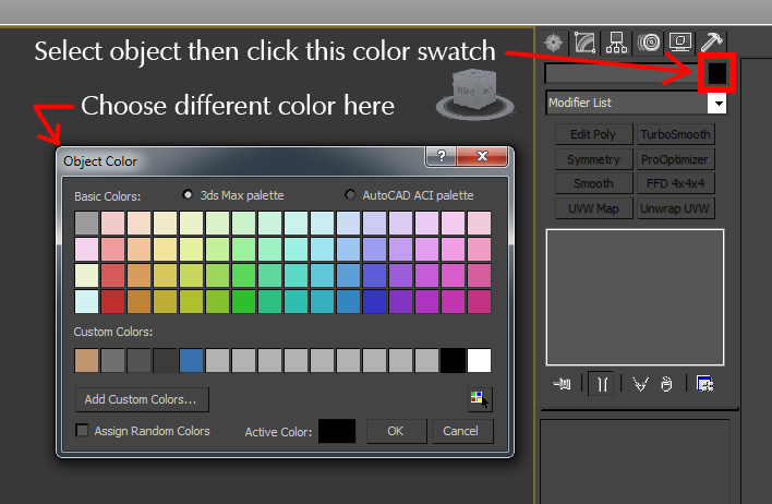

Don't worry about those colored lines. They mean nothing in terms of rendering. It's just the edge color that displays in the viewport. If you want to change the edge color of an object to something else, simply select the object, click on the little color swatch next to the object name and then choose a different color from the "Object Color" pop up window. Be aware though, if you don't have a material assigned to the object, the entire object will change to the color you selected.

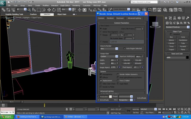

Now I started working on this model - a living room that, IIRC, I d/l from the same place where I got this kitchen model. The living room model sub structures are all black, just like the kitchen was originally, but when I tried following your instructions for the Vray stuff as I did with the kitchen model, it didn't work on this living room model, although I was able to make some changes to it,

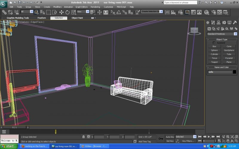

This is the living room model I d/l living room model WIP
and so far, I've deleted several items and added a new floor (after accidentally deleting the original floor), added a new wall with an opening for walkway/doorway and moved the sofa.
I've also moved the TV and the plant.

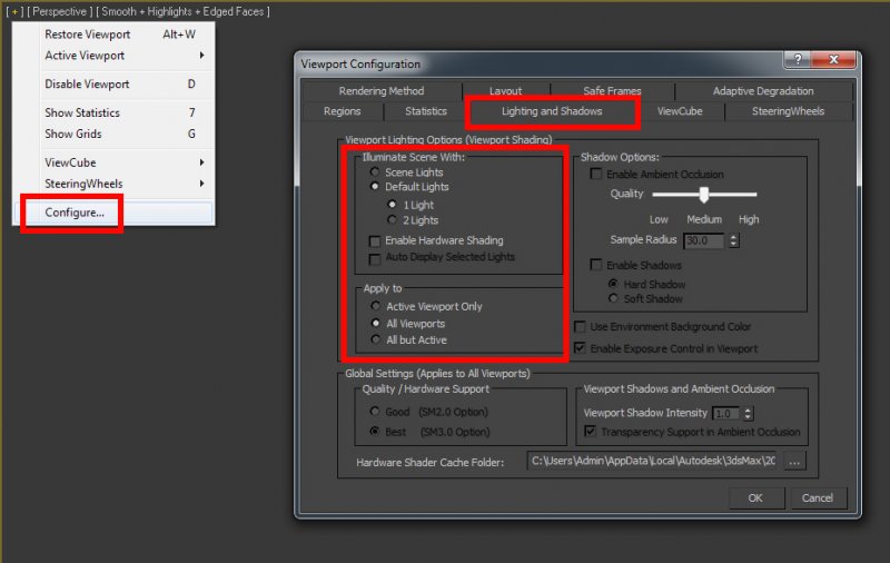

Ok, the models still appear black because there are no lights in the scene. So either create a light or turn the default lighting back on.
To turn default lighting back on, click the little "+" symbol in the upper left corner of your viewport and then choose "Configure" from the pop up menu.
In the Viewport Configuration window, go to the "Lighting and Shadows" tab
Select "Default Lights" and "1 Light" and select "Apply to all Viewports".
