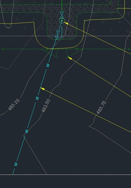

How do you change the text orientation on a pipe network?
For example, I know you can change the direction of a pline by editing it, but what if it is a pipe network? I don't want to change the direction of flow, just the text of the linetype.
You will have to redefine the linetype. Since r2012, there has been an upright text flag option for the Rotation flag.
rotation
U=value, R=value, or A=value. U= specifies upright or easy-to-read text. R= specifies relative or tangential rotation with respect to the line. A= specifies absolute rotation of the text with respect to the origin; that is, all text has the same rotation regardless of its position relative to the line. The value can be appended with a d for degrees (degrees is the default value), r for radians, or g for grads. If rotation is omitted, 0 relative rotation is used.
Rotation is centered between the baseline and the nominal cap height.
Note: Drawings containing legacy linetypes that do not use the U (upright) rotation flag can be updated to the latest linetype definition by reloading the linetype from the LIN files. Custom linetypes can be updated by changing the R (rotation) flag to the U (upright) flag prior to reloading a linetype definition.
