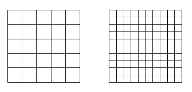

What I meant by mesh density is such as below image:

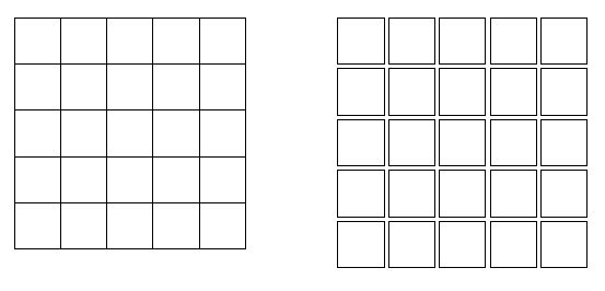

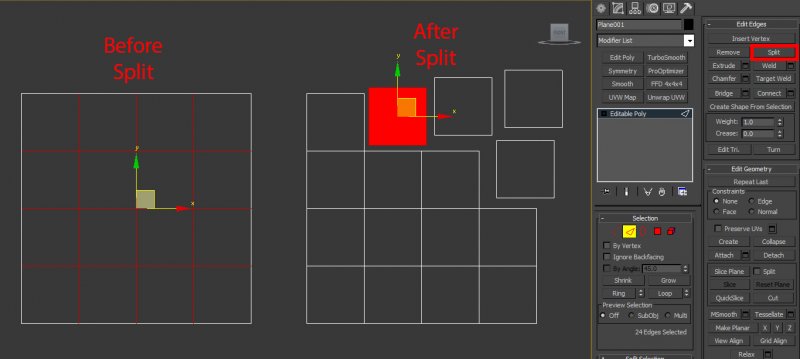

How to explode a 3D object so that all meshes are explode?

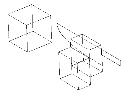

How to slice a 3D object such as below image so that a single object be divided as two:
Can you tell me the step, if can be done, how to reduce the mesh size from less to much?
Also, can you tell me how to slice any 3D object in 3ds Max.
If you just want to increase the mesh density, click the Tessellate button.
If you want to explode an object, select all edges and then click the "Split" button.

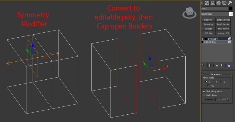

An easy way to split an object in half is by using the Symmetry modifier. Apply the modifier to your object, then in the symmetry parameters, uncheck "Weld Seam". Now convert to editable poly and you will have two halves that you can move apart. Once you move them apart, switch to "Border" selection mode, select the open boundary edge on each object and click "Cap" to seal them up.

Thanks for sharing this technique Cad64. Very helpful in modeling. Regards 8)
