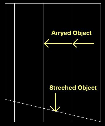

asos2000 Posted November 16, 2008 Posted November 16, 2008 Could I stretch an arrayed object to match the stretched box? See attached - JPG file - DWG file (DB Included) DB-Stretch.dwg Quote
ReMark Posted November 16, 2008 Posted November 16, 2008 You want the vertical lines to terminate at the beveled edge? Trim them. Quote
asos2000 Posted November 16, 2008 Author Posted November 16, 2008 This is Dynamic Block and the vertical object is arrayed, How can I trim that object? Quote
ReMark Posted November 16, 2008 Posted November 16, 2008 Good question. Wish I had that info previously. I wonder if Trim to a Nested Object (Express Tools) would work. Quote
dbroada Posted November 16, 2008 Posted November 16, 2008 not easy, at least I haven't found a way yet. I assume you are stretching sideways to perform the array followed by stretching in the vertical direction. Quote

dbroada Posted November 17, 2008 Posted November 17, 2008 When I said "not easy", I should have said - "I don't know a way". I've now looked at the block and can't see a way to do it. It may be possible to incorporate a wipeout but since I never use them I don't. Out of interest, I tend to use parameters with only 1 grip. I find it far less confusing adding reactions to only one side. Obviously there are times when 2 grips are required but I try to find other ways then. Quote

dbroada Posted November 17, 2008 Posted November 17, 2008 the problem is the line is part of a dynamic block. The lines won't exist until the block is stretched sideways. You won't know what length to make them until it has been stretched vertically. Therefore you have to apply an unknown number of scale actions (you have to scale each individually else the pitch will change) by an unknown amount (which is determined by the vertical stretch. In itself it is not too big a problem but by being buried within a block the variables get out of hand (in my opinion) Quote

MaxwellEdison Posted December 2, 2008 Posted December 2, 2008 I don't know of any way to trim the vertical lines from the array, but have you explored the option of using a hatch? A proper hatch pattern of vertical lines could use the scale to represent the gap between the lines, and it should continue to stretch to fill the boundary. Make sure you set the hatch to be associative so it will update when its boundaries change and also set the base point of the hatch to coincide with your DB's base point and that should keep the spacing regular as well. I attached a quick 5 minute sample of what I mean. Let me know if it works for you. SampleDB1.dwg Quote
