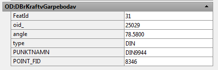

Click OK and the points will be imported -or- if you want to import the data along with the points (as Object Data), then follow these steps before clicking OK
a) Click the box below Data (it will say None)
b) Another dialog will appear, choose Create Object Data, then press OK.
The points will be imported (there are 47 in your files)

YES! *punches fist in air* Thanks RK! The points as such didn't seem to have the information I was looking for, but the lines that I got in another file (I have 6 of these sets of files) have the height of the pipes set in object information.
Awesome!
Awesome!
Just an FYI, the points do have some object data, but you say it wasn't what you were looking for?
No, the points are probably the center of manhole covers, but there's another file with lines that connect all the points, i.e. representing the waste water pipes, and with your excellent description I was able to get those lines imported and they had the in and out-heights assigned. Now to fgure out what is in and what is out....
