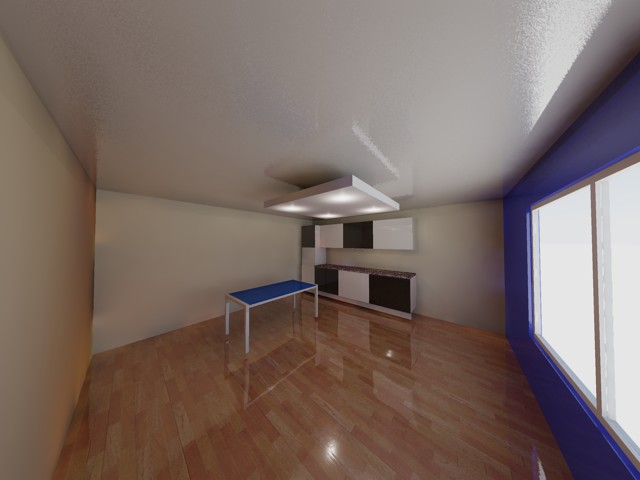

tzframpton Posted March 28, 2013 Posted March 28, 2013 What about them? This is a very low quality render. I'll need a much better render first. The file will help too. Quote
Cad64 Posted March 28, 2013 Posted March 28, 2013 As mentioned previously, you need to bump up your render quality settings. As long as you continue to render with low quality settings, you will continue to get these grainy low quality images. Go here: http://usa.autodesk.com/adsk/servlet/item?siteID=123112&id=10975906, download the zip file and read through the pdf that's inside. Quote
gmarkov1 Posted March 28, 2013 Author Posted March 28, 2013 You mean that these shadows around the ceiling depend (above the window and left wall) just on rendering quality (from Low to Presentation)? Sorry, if I am bothering you... StykFace I didn`t understand your last sentence. What do you meant? You wrote "The file will help too." Thank you, both! Quote
Cad64 Posted March 28, 2013 Posted March 28, 2013 You mean that these shadows around the ceiling depend (above the window and left wall) just on rendering quality (from Low to Presentation)? Check my last post. The pdf in that zip file will explain a lot. Quote
gmarkov1 Posted March 28, 2013 Author Posted March 28, 2013 This is my last render with High quality settings. It is far much better. Cad 64, I will read that pdf tomorrow. I am a little bit confused about the white shadow on the ceiling, above the window. But may be it is a physical reflection. If you have any ideas for improvement I will be thankful... Quote
tzframpton Posted March 29, 2013 Posted March 29, 2013 That looks very good. Coming along nicely. The white shadow above the window on the ceiling isn't a shadow at all. It's simply glare from the outside light. What causes this is the material. There's some reflectivity texture applied to the material. Change it to something else and you won't notice it. For instance, look at the floor... notice the glare of the light sources... it's the same thing. Quote
