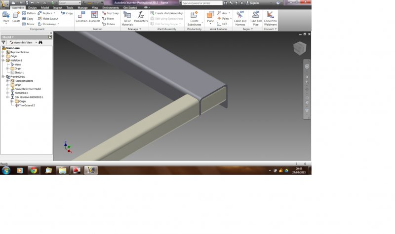

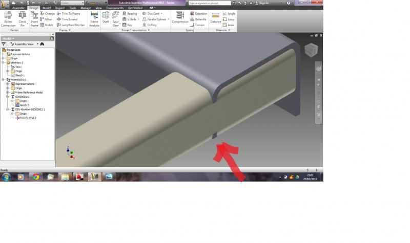

I am trying to clean up a small section of a custom profile channel that is left behind after a 'notch' command in the frame generator in Inventor 2012
I have been playing around for a while now and can't seem to get rid of it. Could anyone shed some light?
Any help appreciated
Adam
You will have to add an Extrude Cut at the part level for that frame member.
I feared that may be the case, thank you for replying
