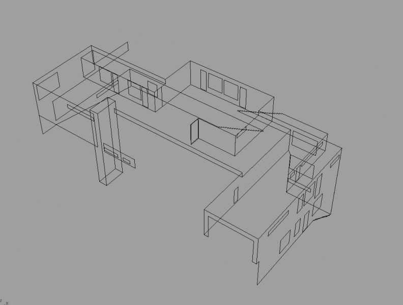

efilana Posted April 8, 2013 Author Posted April 8, 2013 Hello Rewind and Cad! Sorry about long silence - I was remaking my model. I guess I need to describe in details what I need, because I can't really do it on my own. My final goal is to render this model in Vray and also transfer it in UDK (for real-time render). I had these PDF files, which I opened in Illustrator, cleaned, and transferred into Rhino in order to build a 3D model. I built a wire model (please see it in attached file), with intention to transfer it layer by layer into Max, extrude walls, build floors, details and so on. The model is very complex (it is Tugendhat villa by Mies), so you can't just extrude all walls at once. I ran into million little problems, like all beginners. 1. Rhino objects are not properly recognized by Max, so I traced them in Max. 2. I have trouble moving and snapping. I know how to move using move tool, but I am not sure how to snap it precisely to the corner. This is where I got stuck. But most importantly, I don't know if I am on a correct track - I really don't know how to build such complex model in Max. If you guys can help me, even partially, I will really appreciate it. Thank you! E. Quote

Cad64 Posted April 8, 2013 Posted April 8, 2013 1. Rhino objects are not properly recognized by Max, so I traced them in Max. If you want to build the model in Rhino and then render it in Studio Max, just Export your Rhino model to .dwg format and then Import that into Studio Max. Quote
