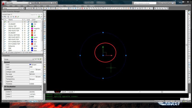

Okay, i was working and this randomly popped up. Its messing me up in terms of me moving objects around. How the heck do I turn this off (Circled)? I apologize in advance if my post sounds a bit angry (Cause I am!)
Also I don't even know what it is!
It's the "Gizmo". Turn it off via your Ribbon. Home > Selection > No Gizmo.
I knew I can count on you ReMark. Now....to scower and find the "Off" button for the gizmo.
Ah, Now I got it. Thanks +1!
