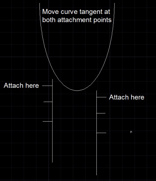

I have come up with a parabolic curve from a 'Sag Chart' program for calculating wire sag between Utility Poles. I now need to place this curve into my Profile that has the poles laid out in it. I need to make the curve Tangent at each attachment point between two poles. The best I can do as of now is eyeball it in there which will get me the sag distance pretty closly but as any Autocad user knows if it isnt exactly aligned it will drive you nuts. I made a rough sketch of what im trying to do.
How do you ant to deal with the difference in levels of the end points of your catenary? Can you not give this information into your software that calculates the catenary and let it calculate the asymmetrical catenary that you require. You could then make a block of the catenary and scale it on insertion to take account of the vertical exaggeration of your profile.
I do not have the software that came up with the catenary. I was only given the appropriate catenary for three different types of wire. :( The levels of all the end points will vary span to span depending on the grade of the ground and pole height. There are several hundred spans in this particular projects.

And I think you mean coincident, not tangent. Show your "eyeball solution" so that the design intent is clearer.

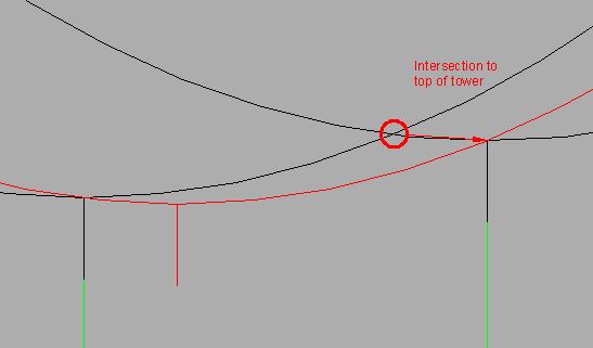

I think there may be a simple solution to the problem.
First place a copy of the catenary on the top of each tower. Then move one catenary using the intersection with the next catenary as the base point, to the top of the next tower. And so on down the line of towers :D
