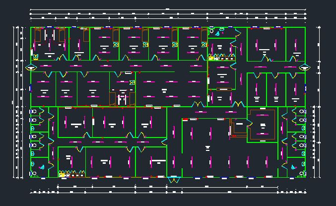

MisterJingles Posted April 3, 2013 Posted April 3, 2013 Hi all I'm wondering if there is a script (I dare not say LISP as I have never used LISP routines) which can simplify my life a little. Our company manufacture and sell modular buildings, our walls are made primarily of 42mm thick 1179mm long panels. So when drawing the plan view of our buildings in MS we simply offset 1 line from another by 42 units and this represents our wall thickness. These buildings can be very large and can comprise of hundreds and hundreds of panels. The sales guys are often asking me for a measurement of all the walls making up a building so that they know how many panels to cost for. Currently I sit in MS and measure each length of wall individually which takes a fair amount of time. Is there a script I could run instead which calculates the total length of line segments on my WALL layer which I can then divide in half to get an approximate total wall length? Sorry for the long-winded question, any ideas? Thanks Rob Quote
ReMark Posted April 3, 2013 Posted April 3, 2013 The drawings have dimensions on them don't they? Quote
MisterJingles Posted April 3, 2013 Author Posted April 3, 2013 The drawings have dimensions on them don't they? Of course, but like I said they can be really large buildings such as the one pictured below. As you can see this can take up some time measuring manually. Quote

rkent Posted April 3, 2013 Posted April 3, 2013 First isolate the wall layer then look into a lisp program like http://www.jtbworld.com/lisp/bomlengths.htm Finally divide by 2. Quote
MisterJingles Posted April 4, 2013 Author Posted April 4, 2013 Thanks rkent this is exactly what I am after. Works a charm! Thanks for your help. Quote
