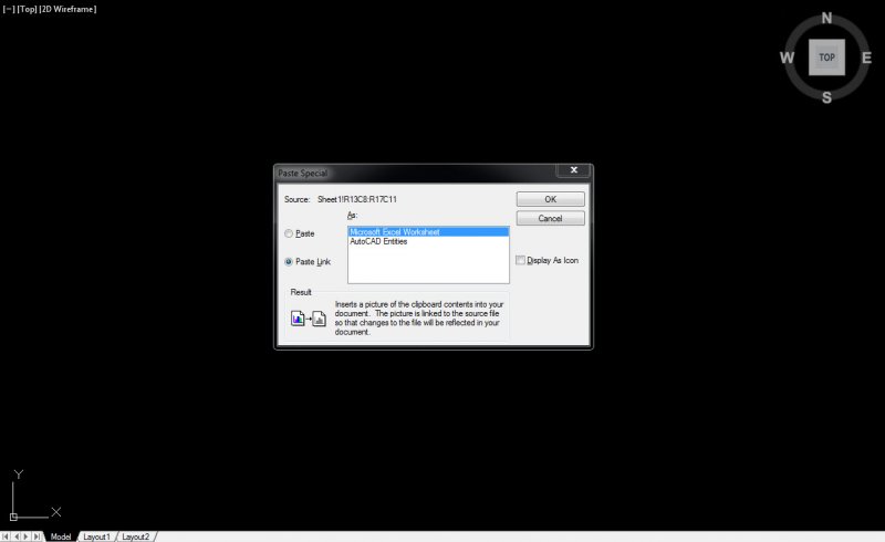

you can use PASTESPEC command from edit menu select the cell in excel sheet an pres ctrl + c then go to auto cad and use PASTESPEC command like attachment Is this what you want

Hi,
Thanks for replay mostafa badran
I've tried doing that but no success.
I was wondering if have possible other way.
Regards
can you Told me what s the problem in this way Exactly

That you tube video is so small on my phone and without narration it appears they are just showing a copy and paste method. But what it sounds like you want is a DataLink. This will allow changes in the Excel file to be updated in the AutoCAD file and visa-versa.
Just do a search or look in AutoCAD help for datalink. I think you will find what you're looking for.
