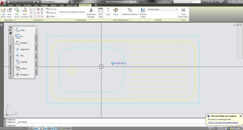

Hi there
I've been battling with this for some time now and feel like an ass for having to ask.
I use the RIBBONS when using ACAD, when creating Dynamic Blocks with Visibility States I am able to add, rename etc the states, but when I need to tell ACAD what to hide and what to show in each state I cant seem to locate the button within the ribbons to do so.
I find myself having to switch back to CLASSIC view to use them and then back to RIBBON.
See the 2 images.
Please put me out of my misery :)
CLASSIC VIEW
RIBBON VIEW
In MEP 2011 they are in the visibility panel. Don't know why you don't have them.

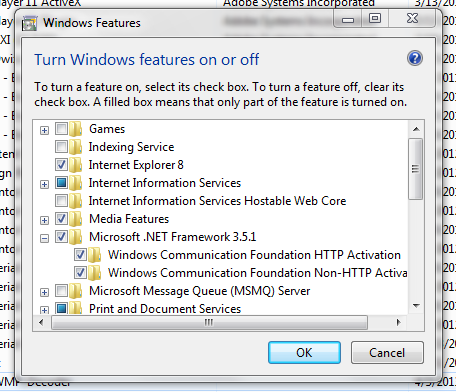

I see you are running Windows 7. There is one thing you should also check. Make sure NET Framework is fully enabled. Go to the Control Panel > Programs and Features > Turn Windows features on or off. Make sure the three boxes shown below are all checked off.
Thanks ReMark, those 3 boxes were indeed unchecked. I have checked them, rebooted the machine but unfortunately still no change within ACAD.
