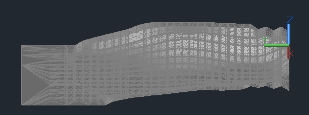

octo12 Posted April 4, 2013 Posted April 4, 2013 I have imported data showing the contours of a surface into autocad.. I want to output it as an .stl of the same contour map but with a higher resolution and smoothed out. I created a mesh and exploded, but now at the stage where I want to convert to solid it doesn't let me do it.. Is there a way of making the mesh into a solid? Command: _convtosolid Mesh conversion set to: Smooth and optimized. Select objects: Specify opposite corner: 53646 found Select objects: Specify opposite corner: 37336 found (6124 duplicate), 84858 total Select objects: 84858 objects cannot be converted. Command: Command: Command: _EXPORT Select solids or watertight meshes: Specify opposite corner: 84858 found Select solids or watertight meshes: Selected objects must be solids or watertight meshes. 84858 objects removed from the selection set. Quote

JD Mather Posted April 4, 2013 Posted April 4, 2013 I have imported data... What format was the imported data? Is that a picture of the original or after you tried to "fix" it? Quote
octo12 Posted April 4, 2013 Author Posted April 4, 2013 Yes thats after I "fixed" it ;-) there was no mesh before.. I can also upload the original before any possibly counterproductive tinkering Quote
