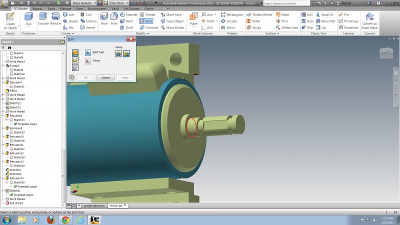

I need to take one part and split it into two. The primary reason for this is to be able to print a 12.5" part on a 3D printer with an 8x8x8 size limitation. It is a somewhat complex part, and I don't want to have to start over and make two things and glue them together later.
The other reason is that i have modeled a part as one solid body and it should have been two. A motor with an output shaft. This part is simpler, so I could easily make it agian, but I need to learn how to do this. Anyone?
Sketch split line.
Exit sketch.
Select Split and set to option Split Part.

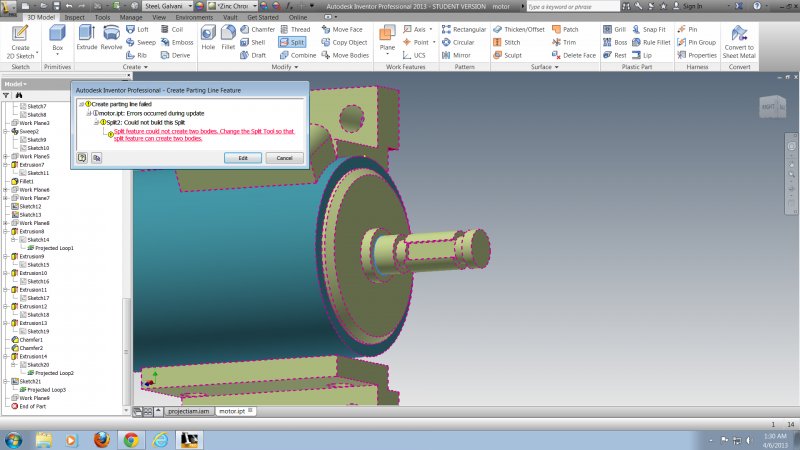

See attached pictures and the ipt for the motor. Sketch 21 is where is select for the split. Whats the deal:?
motor.ipt
Split should work, but something is wrong with the model that it doesn't, so

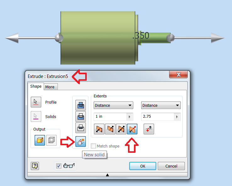

I'll show you how you it should have been done from the beginning and we will fix this part of the model -
Edit Extrusion5 and set it to Asymmetric (to send the rotor shaft back into the stator housing) and set to New Solid as shown.
(accept any error messages)

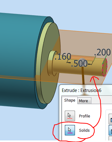

Now that you have two solids, Extrusion6 (and several other features) do not know which of the two solids they belong to.
Edit Extrusion6 (Edit Feature) and activate the Solid selection tool and click the shaft as the solid that the keyway (Extrusion6) belongs to). OK and Accept any errors.
Repeat for each feature that shows an error in the browser working your way down from top to bottom (some of them will start fixing themselves).

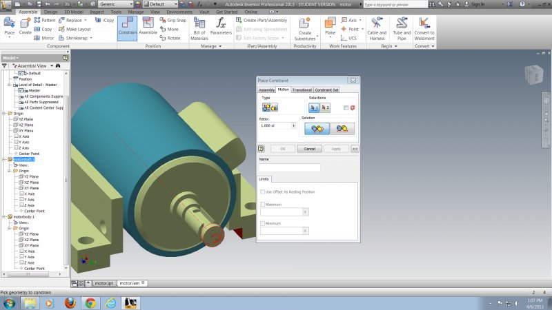

Now that I have the new .iam, how can i make a constraint about the center axis and drive it, say 10,000 degrees so it looks like its spinning? This is what I've tried and had no luck with:
When you pushed out the assembly both parts were Grounded in position (see thumbtacks in browser).
Do not do not do not unground the motor.
You will need to unground the shaft.
You will then need to add a Mate constraint between the axis of the shaft and the axis of the motor. (simply select the cylinders)
You will then need to add a Mate -Flush constraint between the Origin planes of the motor and the shaft that are perpendicular to the axis (looks like XY planes in image, but not sure)
The shaft should now rotate in position when you drag it with mouse.
In the image you are trying to use a gear type motion constraint - this is not correct.
Add a Directed Angle constraint between a plane parallel the axis in the motor and shaft (looks like YZ plane).
Right click on this angle constraint after creating and select Drive Constraint, enter the number of degrees to rotate and click play.
You can also Animate Constraint this angle constraint in Inventor Studio.

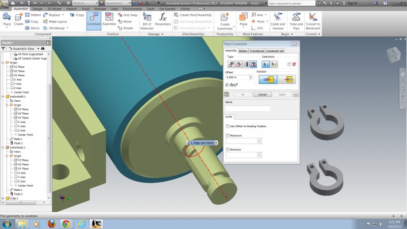

So now, I can model a gear, place it in the assy., constrain it to the shaft, add woodruff key and two c-clips, and be in good shape? I have been using the inventor studio a bit, and I know that I can animate constraints within it. At that time would I use the gear type motion constraint?
I need to know what constraints to place on the objects. See attached for cclip placement.
The Grounded sets the position of the "base" part.
Use Insert constraints for the c-clips. Mate Flush origin planes between c-clip and shaft.
