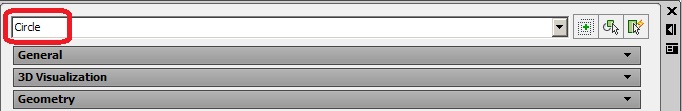

Find one of these compound objects (you use the term groups). Select it. Right click and select Properties, or check your Properties pane if it's already open. That will tell you exactly what type of object it is, and with that you'll know how to edit it. A block, for instance, you can edit with the Bedit command (as MSasu suggested).
When you select the object>Right-Click and select Properties, what is in the description at the top?Properties.jpg
