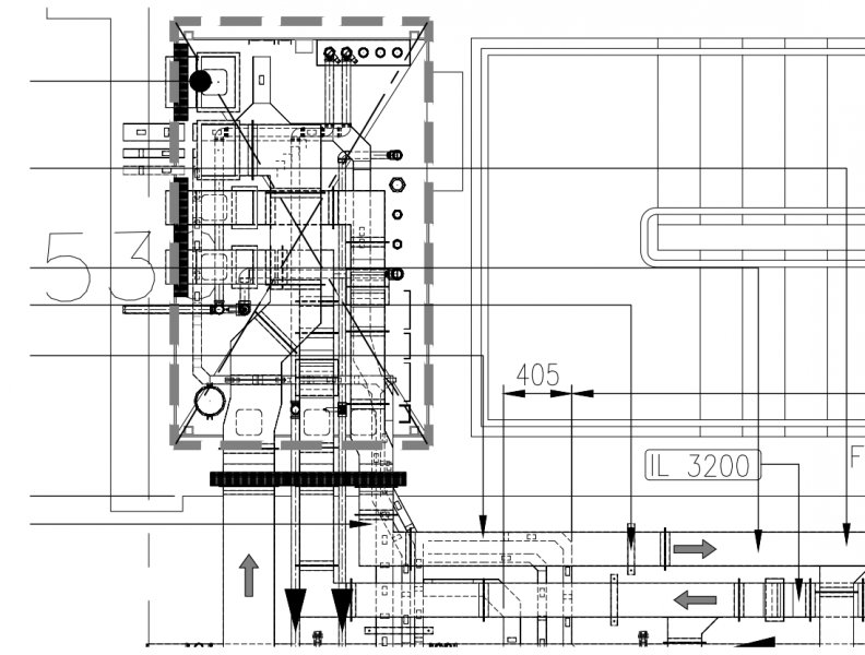

I was wondering if there is a system variable or setting to enable a background mask, say 1mm offset of the line of leaders. This would save me a fortune of hours, re-noting drawings and re-drawing leaders. 8)

I've attached an example of the issue I'm facing having poorly (sometimes un-movable leaders) - What I thought may increase clarity and reduce my monotonous work load would be to add a background mask to the leader so as to embellish it on the paperspace, making it more traceable when printed by our clients.
Are you looking to add a background mask to the leader text (i.e. 'IL 3200' in your example), or to highlight the leader line? If the latter, I recommend that you use different lineweights for your leaders.

Hello all. I'm writing to find if anyone knows of a way to mask the actual leader itself. I have drawings with photos in them. And we point to objects in the photos. Having a leader masked is critical - so the leader termination can be legible. And I'm regretfully always drawing a wipeout around all leaders - time consuming any rather annoying. Is there a lisp, script or the like for masking the leader - not the text? Thank you. I'm not trying to hijack a thread here, let me know and I'll report. I just wanted to make sure the subject matter experts saw my request for help. Thank you.
Since AutoCAD does not offer the ability to mask a leader line, I suspect that a wipeout would be required to obtain the desired result; however, I should imagine that it would be possible to automate the generation of such a wipeout by retrieving and offsetting the leader line vertices and creating a polygonal wipeout from these points.
Are you able to post an image of the result you are looking for?
An alternative solution might be to represent the leader using an attributed dynamic block containing various parameters allowing the user to stretch & modify the leader line, and embed the wipeout within the dynamic block itself so that it is stretched simultaneously with the leader line, creating a mask effect.
