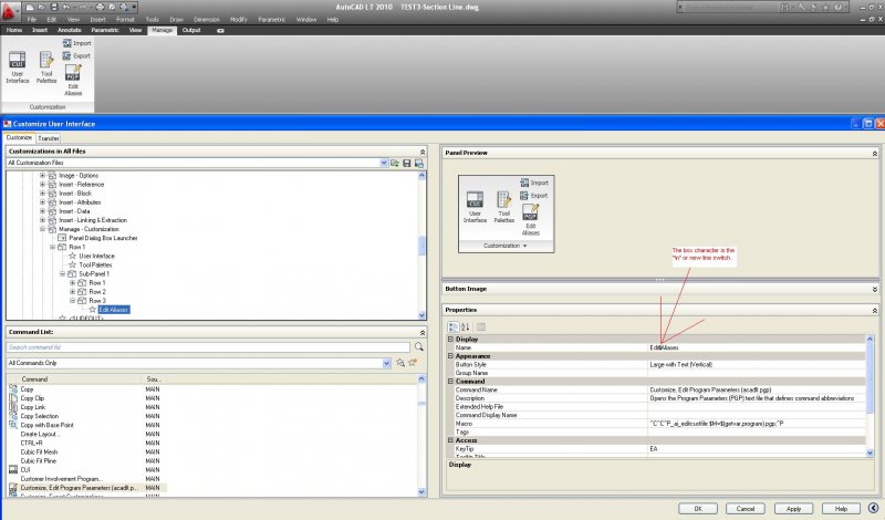

So you want the button text to have an /carriage-return in it?
Add the text "/n" in the Display Name box where you want the /carriage-return. Just to warn you... this 'new line switch' will not be displayed as "/n" but as a one character box. The two attached screenshots should clarify what I mean.

Woops. I see I had it right in my screenshots but not in the post. Sorry for the mix up.:(
