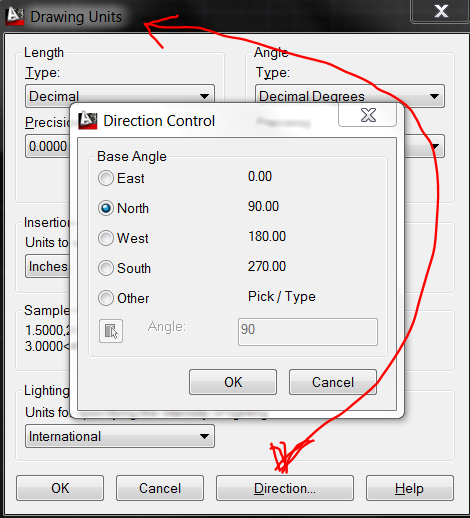

You might also look at this
or maybe not. I forget what this does. I thought there was a way to switch CW to being positive, but now have long forgotten.
You can specify rotation direction as shown in the image. :)

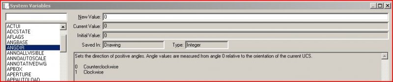

[ATTACH=CONFIG]41367[/ATTACH]

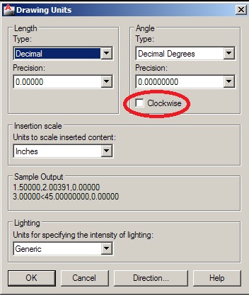

There is also a checkbox for Clockwise under Angle.
I knew there was one somewhere but thought it was in that Direction Control dialog that was hiding it from me.
