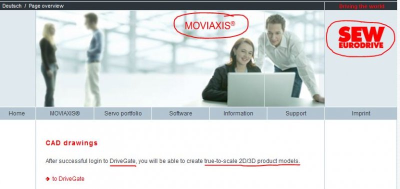

ReMark Posted April 12, 2013 Posted April 12, 2013 You don't draw the panel "to scale" like you would on a drafting board. You draw it full size. If the panel is 30" wide and 72" high that's what you draw. Same goes for your components. Have you checked the website of the company whose components you are using to see if they have pre-drawn blocks in either DWG or DXF format available for downloading? Would these components happen to be Profibus function modules? Quote

milmat1 Posted April 15, 2013 Author Posted April 15, 2013 when i installed ace2008 there was literally thousands of components available, by manufacturer (ABB, Siemens, Telemechanigue, Mitsubishi many others)....all the major elec stuff. you need to select what blocks are installed tho. by default none are. put the disc back in your dvd drive and install them I requested the disc from IT and will have a look Thanks!! There are quite a few more. Did you visit the website I provided the link for? Since you are using ACADE 2013 it's possible that all libraries and catalog content were not installed. This oversight can be rectified via the Windows Add/Remove feature found in the Control Panel under Programs and Features. Would your company at least spring for a good book about ACADE? Figure $80 (without tax). I'm sorry if I overlooked it but which link ? Here or in the other thread ? Quote
milmat1 Posted April 15, 2013 Author Posted April 15, 2013 Yea I registered etc and got to the PT-PILOT and it doesn't list ACE2013 as a choice. It wont recognize any of my part no's. The only one it will except goes to "Generating Files" and sticks there.....I give up on SEW ! Quote
