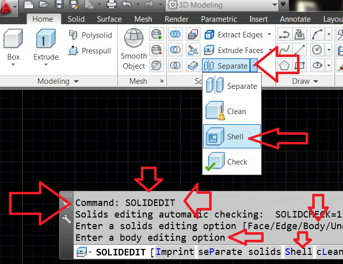

vanessamba Posted April 13, 2013 Posted April 13, 2013 I am trying to shell a solid and ask me OS Comand, what's that? The normal it is ask the faces to shell :s Quote
JD Mather Posted April 13, 2013 Posted April 13, 2013 You are confusing an old DOS command "shell" with an AutoCAD command solidedit>Shell. Type solidedit hit Enter key and read command line. Or use the Ribbon icon. Do not type Shell and hit Enter. BTW you should have started a new thread for this question as it is not the same question. Quote

dbroada Posted April 14, 2013 Posted April 14, 2013 No, i use Shell and appeared OS Comand like in the image https://plus.google.com/photos/109332255431732617372/albums/5866357189143227489/5866358389212799458 which is exactly as JDM said. The SHELL command starts an external program. DO NOT use it but use the one he indicated. Quote
JD Mather Posted April 14, 2013 Posted April 14, 2013 The command is SOLIDEDIT, not shell. Then you want to select the Body option (if not using using ribbon icon). And then the option Shell. Beginners who don't know the program are probably better off using the ribon icons Quote
