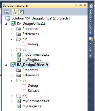

You may name your files any way you choose, but just as an observation... WRT .NET Development, you may find it useful to suffix the assembly name with the Database version you've developed the plug-in for (i.e., RA_DesignOffice18.dll, and RA_DesignOffice19.dll, etc.) instead of the release version's year as the plug-in is compatible with all version year's on the same major Database version. :thumbsup:
This is especially useful when you have a single Visual Studio Solution, with multiple (Database-specific) Projects, which each build their own resultant assembly (see second image attachment).

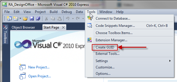

Separately, especially so if you choose to use Autoloader one day, you'll want to add an External Tool to your Visual Studio setup, specifically 'Create GUID' (see first image attachment)... This tutorial shows you how to add.
** ETA - I went to replace one of the images, and now they won't sort in the order I want for some reason.
