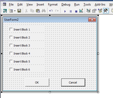

i'm trying to insert 6 blocks that i constantly use into my drawings. I would like to be able to check which blocks i want and then click 'OK' and the blocks insert to 0,0,0. I currently have all my blocks in a master file.
being new to VBA i have no idea where to start. does anyone have anything similar i can work with?
I Have attached what my menu will look like.
Cheers guys, i appreciate all your help. :)

this should work:
Public Sub InsertBlock()
Dim BlockRefObj As AcadBlockReference
Dim P1(0 To 2) As Double
P1(0) = 0: P1(1) = 0: P1(2) = 0
If CheckBox1.Value Then Set BlockRefObj = ThisDrawing.ModelSpace.InsertBlock(P1, "Block1", 1, 1, 1, 0)
End Sub
you will obviously have to draw your form and ensure that Block1 is available. I have removed all the layer information as that may have been causing your problems.
